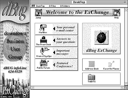

FirstClass
FirstClass BBSs are actually most commonly used as conferencing systems within large companies and organizations. However, they're also extremely popular among the user group community (see figure 13.1).

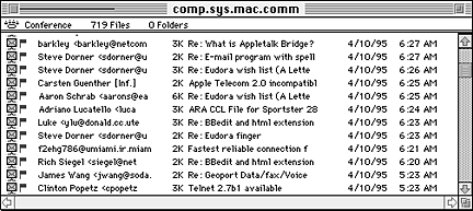

FirstClass can receive Usenet newsgroups via an Internet gateway, which is an excellent way to bring more information into a fairly small BBS. Unfortunately, the current interface to reading news isn't as full-featured as I would like. Working with threads is difficult or impossible, and there's no easy way to entirely skip an uninteresting thread (see figure 13.3).
Figure 13.3: FirstClass newsgroups.

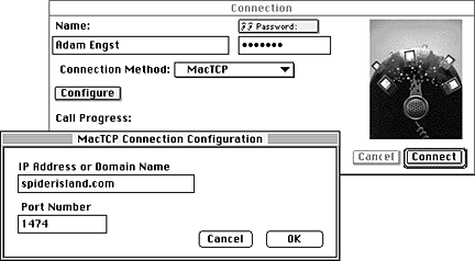

TeleFinder User is easier to configure than TeleFinder Pro because you don't have to muck around with changing ports or anything like that. When you launch the program, it presents you with a Connection dialog, in which you can enter your username, password, and the connection method (see figure 13.9). Clicking the Configure button brings up a dialog for entering the IP address and port number (1474 by default) of the TeleFinder BBS to which you want to connect.
Figure 13.9: Configuring TeleFinder Pro for the Internet.
