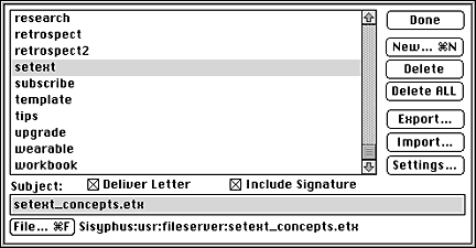

Last is the fileserver address command, which unfortunately no longer ships with UUCP/Connect. Like the others, it was never meant to be an integral part of the program, only example code, but if you call InterCon and beg, maybe they'll send it to you (see figure 15.37).
Figure 15.37: UUCP/Connect Fileserver configuration dialog.
Mail sent to the fileserver address with a specific word in the Subject line elicits a response based on that Subject line. So, for instance, if you had sent email to [email protected] with the single word setext in the Subject line, UUCP/Connect would have sent you a file talking about the setext file format that we use for TidBITS. The capabilities offered by these address commands are extremely useful in any type of professional situation, although an individual user may also find uses for them.
Note: I've found that people prefer using autoreply addresses far more than the fileserver, so if you wish to automatically send out information to people who send email, I recommend using an autoreply address.

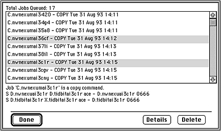

Whenever you send a message, a UUCP program places it in the spool folder along with two other supporting files that share similar names. If you want to delete these files, finding and deleting all three can be a hassle. UUCP/Connect helps by providing you a Job Queue, which lists all the files waiting to go out or, depending on when you look, the incoming files that haven't yet been processed (see figure 15.39).
Figure 15.39: UUCP/Connect Job Queue dialog.
Although the Details button shows you little in the way of useful information (such as the subject of the letter), you can often differentiate messages by the timestamp. I mainly use the Job Queue to see how many messages are waiting in line to go out. This gives me an idea of how much mail I've sent during that session, and also how long the next connection will take if I connect manually.
Note: Since all the files are text files, it's relatively easy to go into the spool:uucp directory with a text editor and look at the contents of each message if you wish to delete a specific one but don't know which it is.
