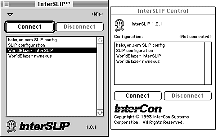

Although InterSLIP Setup and InterSLIP Control share similar interfaces and functions, you use InterSLIP Setup to configure your connection. InterSLIP Control enables you to select a configuration and connect and disconnect, but you must configure it from InterSLIP Setup (hence the name, I suppose) (see figure 19.1). Frankly, if you use System 7, I'd recommend throwing InterSLIP Control out. I haven't had it installed for months now, and it's made no difference at all.

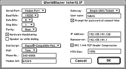

After you create the configuration, you must configure it for your particular modem and account. You need information from your system administrator to configure InterSLIP, so be prepared to give your provider a call if you didn't get it all when you signed up for the account. Double-click on the configuration you just created to bring up the configuration dialog (see figure 19.2).
Figure 19.2: InterSLIP configuration dialog.
Let's take it from the top left of the dialog. The serial port should generally be set to your Modem port, although you could attach a modem to your Printer port. If you use a PowerBook with an internal bus modem that connects directly to the CPU (such as the Apple Express Modem and the Global Village PowerPort/Mercury for the PowerBook 500 series and the PowerBook Duo), you get an Internal Modem choice, and the PowerBook 500 series may show a Printer-Modem Port choice. Although I don't have such a modem to test, I suspect that if you have a nonbus internal PowerBook modem, you should choose the Modem port, just as with MacPPP (also see the notes about bus modems in chapter 18, "PPP").
The Baud Rate setting is the rate at which your modem and your Mac communicate, which is why there is no setting for 14,400, since that's a speed at which the two modems communicate (and some modems cannot even accept a port speed of 14,400 or 28,800 bps). The speed that the Mac and the modem communicate should be set faster than the speed that the modems communicate to take advantage of modem compression capabilities.
Data Bits, Stop Bits, and Parity are almost always set as I have them here, to 8 data bits, 1 stop bit, and no parity, although I suppose it's possible that some providers are different. The Hardware Handshaking checkbox requires that you have a hardware handshaking cable, and if you have a fast modem, you should have one of those. I've heard that if you don't have a hardware handshaking cable but attempt to use that checkbox, it may cause InterSLIP to hang.
Turning the speaker on or off is up to you, although I generally recommend you leave it on until you have everything working for a few days. Then, when the modem screams start to irritate you, turn it off.
Note: Depending on your modem and your modem initialization string, InterSLIP sometimes seems to ignore the speaker checkbox. You can always override it by adding M0 to your initialization string to turn off the modem speaker.
The Dial Script pop-up menu defaults to Direct Connection, something I doubt most people have. The other built-in choice is Hayes-Compatible Modem, and I recommend you choose that option to start with. I certainly hope your modem is Hayes-compatible; you're likely to have trouble if it's not. Unfortunately, even if your modem claims it's Hayes-compatible, that doesn't inherently mean that it works with the Hayes-Compatible modem script in InterSLIP. Luckily, InterSLIP supports other modems through the use of dialing scripts written in the CCL (Connection Control Language). CCL scripts are primarily used with Apple Remote Access (ARA). You can find many dialing scripts (their names start with scr and generally include a modem name as well) in:

The next three items, which control the dialing method, phone number, and modem initialization string, don't appear until you choose Hayes-Compatible Modem or another dialing script. I hope that when these items appear, it is relatively obvious how to fill them in. Most people have tone dialing these days (although the few people with pulse dialing would do well to check dialing scripts for ATDT commands and replace them with ATDP commands), and your system administrator should tell you the phone number when you get the account. The modem initialization string is a bit trickier, but most modern modems support something like AT&F1 for setting the factory default standard options. As you can see, my WorldBlazer goes all out on the &F parameters; I must use AT&F9, which turns on hardware handshaking for the Macintosh. Look in your modem manual or in another communications program that comes with settings for popular modems to figure out the most appropriate initialization string.
Note: I've also included a file containing many modem strings on the disk. The ISKM Installer has the information in the installer help text, and the file is installed in the InterSLIP 1.0.1 folder (not the InterSLIP Folder that lives in your Preferences folder). These modem strings are generally untested, but should either work or put you on the right track.
The most important thing I know of to watch for here is the hardware handshaking setting. Not only do you want to make sure your initialization string turns on hardware handshaking, but you also want to make sure that software handshaking, more commonly known as XON/XOFF, is turned off. If XON/XOFF is turned on in the modem initialization string or is part of the factory default settings (as it is for the Telebit QBlazer modem), InterSLIP almost certainly won't work right.

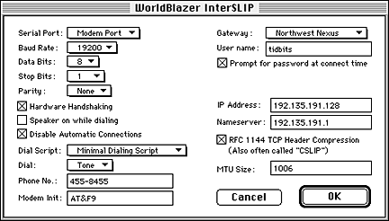

At the top right of the window is another pop-up menu labeled Gateway. It defaults to Direct Connection, but again, I think the other option, Simple UNIX/Telebit, is more commonly used. The Simple UNIX/Telebit script simply looks for the login prompt, sends your userid, looks for the password prompt, sends your password, and assumes there's nothing more to do before starting SLIP. Unfortunately, that's not always true.
Just as with dialing scripts, you can write your own gateway script in the Connection Control Language and place it in the Gateway Scripts folder in the InterSLIP Folder. Unfortunately, if you have a nonstandard gateway, you probably will have to write your own, although I've collected a few of them in:
ftp://ftp.tidbits.com/pub/tidbits/tisk/tcp/
(Look for "scr" in the beginning of the name, and the name of a provider, university, person, or server such as Annex or Cisco in the rest of the name.)
The gateway script is a conversation between your computer and your host computer as your computer tries to log in to the host. There's no telling what sort of prompts your host sends or what it requests, so again, I can't help much with specifics here. I strongly recommend that you work through the process manually using a terminal emulator to see what the host sends and what it expects back. Once you've done that, you stand a chance of converting that information into a gateway script. Also, ask your system administrator to advise you of any quirks in logging in.
Note: A few people need to use what's called a dialback system which, for security reasons, makes you log in normally, then hangs up and calls you back at a prespecified phone number. Although a truly hairy process, you could write a gateway script that, instead of just logging in, would log in, hang up the phone, set autoanswer, wait for a RING, answer the phone, wait for a CONNECT, and then proceed with the rest of the script. Nasty, but possible.
In general, you usually send a return, the host sends a login: prompt, you send your login name, the host provides a Password: prompt, you send your password, and then something else happens. For instance, if you use a server-addressed account, the gateway script must include some method of finding the IP number that the server assigns to you -- it usually appears after you send the password. I've included a gateway script that works with the Northwest Nexus server-addressed accounts, and I recommend that you use it as an example of how to write your own (not that it's a paragon of scripting virtue, but it does work).

Let's move on to the User name field in the InterSLIP configuration dialog. Most of the time, your system administrator assigns this name to you, along with a password, although you may get to pick them yourself. Your username may or may not be related to your machine name or your email address. It's simply the name you use to log in to your SLIP account. Make sure you enter your username in lowercase -- Unix is case-sensitive, so Adam is not the same account as adam, and your password won't work with a mixed-case username if it were created with a lowercase username.
I've checked the Prompt for password at connect time checkbox in the InterSLIP configuration dialog because publishing a screen shot of my password isn't a terribly clever thing to do in terms of security. However, if that checkbox isn't checked, you get another text field that holds your password. If you don't mind the security risk of having your password visible here, go ahead and enter it, being careful to enter it exactly as it was created. Passwords are always case sensitive, so make sure you match the case of each letter or else the host will reject it.
The next four items -- IP Address, Nameserver, checkbox for RFC 1144 TCP Header Compression, and MTU (Maximum Transmission Unit) Size -- require information from your provider. You can see the sorts of things I've put in, but your situation may be entirely different (and your IP Address and Nameserver certainly are). Again, if your provider tells you that you have a CSLIP account, make sure to check the TCP Header Compression checkbox. Even if the term CSLIP isn't mentioned, make sure to check with your administrator, because if the TCP Header Compression setting in InterSLIP doesn't match what your account has set, weird errors will result.
After you're all done, click on the OK button to save your changes. If you have more than one SLIP account on different hosts, you can create additional configuration files and switch between them in InterSLIP Setup by selecting the one you want before you click on the Connect button.
Clicking on the triangle in the upper left of the InterSLIP Setup window shrinks the window to display only the Connect and Disconnect buttons and the area that displays the connection status (see figure 19.3).
Figure 19.3: InterSLIP Setup window, shrunk.
If you have only one configuration, the only reason to leave the window expanded is if you need to edit your configuration frequently (which shouldn't be the case). InterSLIP Setup also remembers where on the screen you put it, so it's easy to put it out of the way and leave it active most of the time. InterSLIP Setup takes only 128K of RAM, so it's no great liability.
