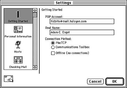

  2. From the Special menu, choose Settings.
    Eudora presents you with the Settings dialog. Notice that the dialog has icons running down the left side, and clicking an icon brings up controls for that icon's options (see figure 29.21).
    Figure 29.21: Getting started in the Eudora Settings dialog.
  3. If you keep the Getting Started icon selected, you should see the settings for Getting Started, as shown in figure 29.21. In the POP Account field, enter your POP account (get this information from your provider) and be certain to enter it in exactly the same case as your provider used, usually lowercase.
  4. Press Tab or click in the Real Name field. Enter your real name as you would like it to appear in your email messages.
  5. In the Connection Method area, turn on the MacTCP radio button.
    You have now completed filling in the Getting Started portion of the Eudora Settings dialog. We are going to skip the Personal Information option and move on to the Hosts settings.

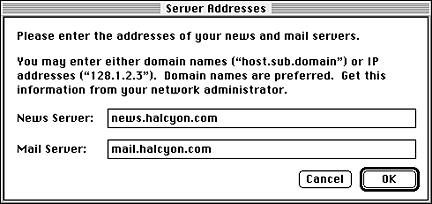

    The Server Addresses dialog appears. If you configured Internet Config, the fields will already be filled in (see figure 29.30).
    Figure 29.30: Configuring NewsWatcher.
  4. If they are not already filled in, fill in the News Server and Mail Server fields using information you have obtained from your provider.
  5. Click the OK button.

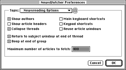

    Figure 29.31: NewsWatcher Preferences dialog.
