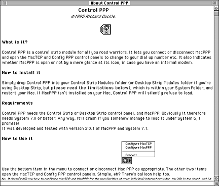

This postcardware utility from Richard Buckle makes it easier for MacPPP users to connect and disconnect. Control PPP is a Control Strip module that enables you to connect and disconnect from the Control Strip, and to open the MacTCP and Config PPP control panels. It also indicates if MacPPP is open or not, which is handy for PowerBook users with internal modems. Although written for Control Strip, Control PPP also works with some limitations with Desktop Strip, which lets desktop Macs use Control Strip modules, and probably with a similar commercial utility called DragStrip.

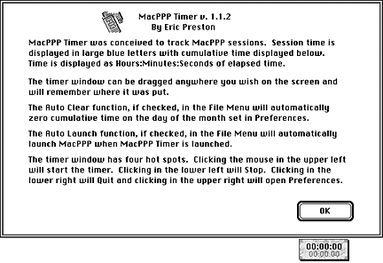

MacPPP Timer is a small utility application from Eric Preston that helps you keep track of how much time you spend connected to your PPP account. You must launch it manually, but because you can open a MacPPP session from within MacPPP Timer, that's not a serious hardship. Once active, MacPPP Timer automatically displays the amount of time you're connected for that session and for a cumulative amount of time (a month is the default, based on most providers' billing schemes). If you're billed by the hour and want to keep an eye on your charges, check out this program.

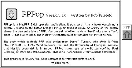

Those who don't like working with the Config PPP control panel might want to check out Rob Friefeld's free PPPop, which is a small application that serves as a front end to MacPPP. Like other utilities for controlling MacPPP, PPPop enables you to connect or disconnect, open the MacTCP and Config PPP control panels, and see the status of your connection at a glance. The coolest feature of PPPop is that it plays sounds from a PPPop Sounds file located in the same folder. PPPop comes with a set of sounds, and you can create your own and replace the standard sounds if you like.
