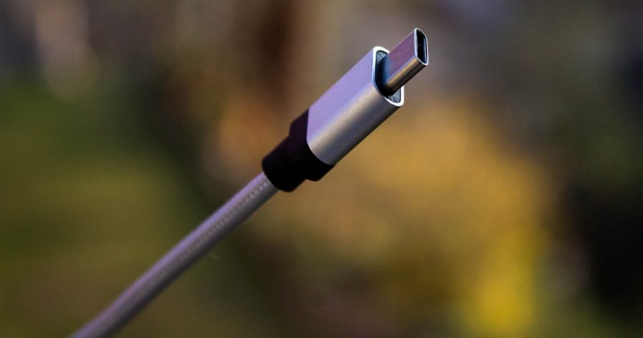

A USB-C plug.
Photo by denvit on Pixabay.
