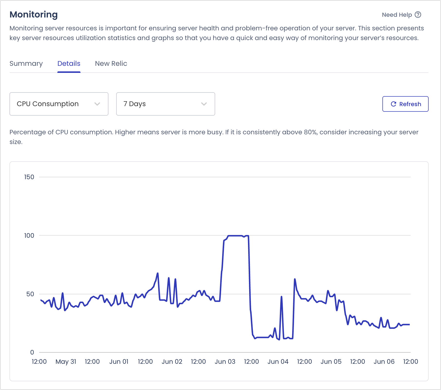

Last Wednesday, I woke up to alerts from different monitoring systems about issues on my server. Jetpack kept informing me that the TidBITS Content Network site was going online and offline, and Cloudways sent emails about my nightly backup failing and the server having high CPU usage. When I tried to load the TidBITS site, it either took a long time or didn’t load at all.

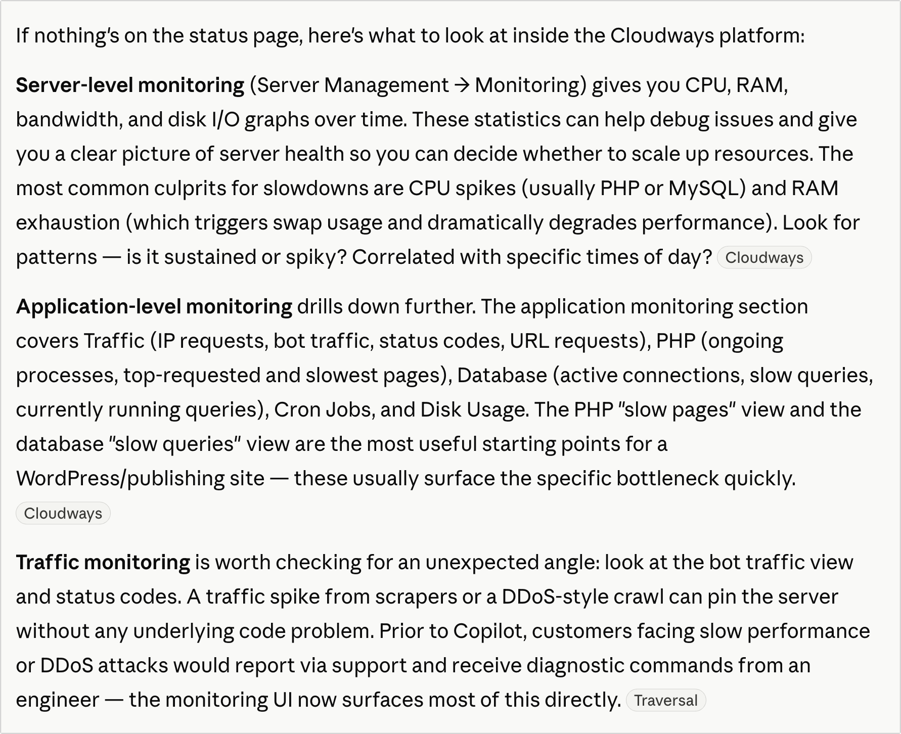

I started with a fairly general query: “My TidBITS server at Cloudways is having problems. It’s either being really slow or going down entirely. What can I do at Cloudways to see what’s happening?” Claude’s initial advice was solid: rule out a Cloudways outage (there wasn’t one), check server-level monitoring, and drill in with application-level monitoring. I might have figured these things out myself, but since I haven’t had to do much at Cloudways since we set up the server almost two years ago, I’m unfamiliar with the interface. Claude’s directions included navigation paths to the specific monitoring reports I needed.

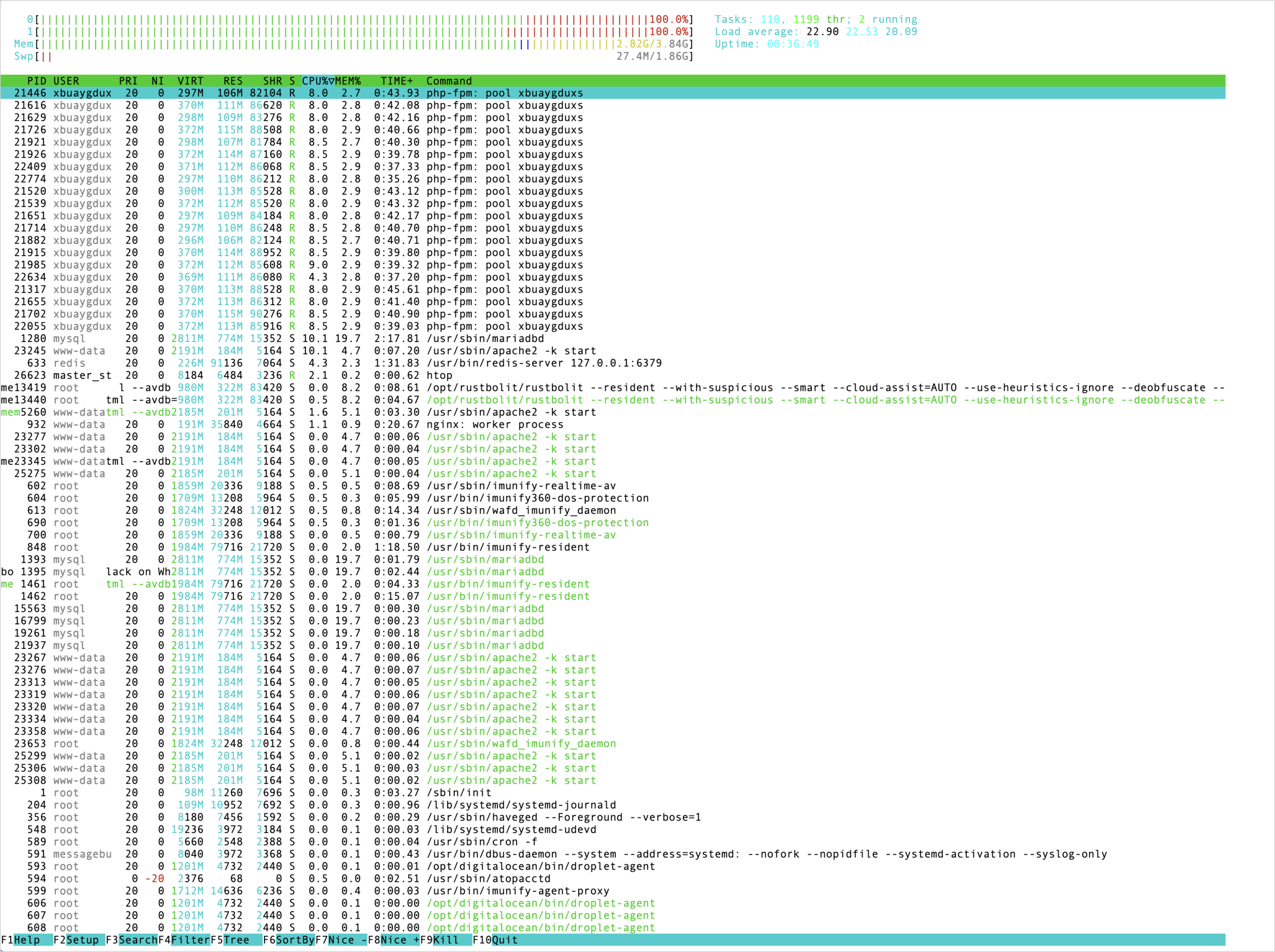

The server-level monitoring revealed that CPU usage was pegged at 100%, and when I informed Claude of that fact, it made a number of suggestions, and I took the first one, which was to run htop in an SSH terminal session. I am somewhat familiar with top, but the interface in htop looks a bit different, so I took a screenshot and pasted it into the Claude chat. It did a great job explaining what everything meant and how I could learn more about the traffic causing the issue.

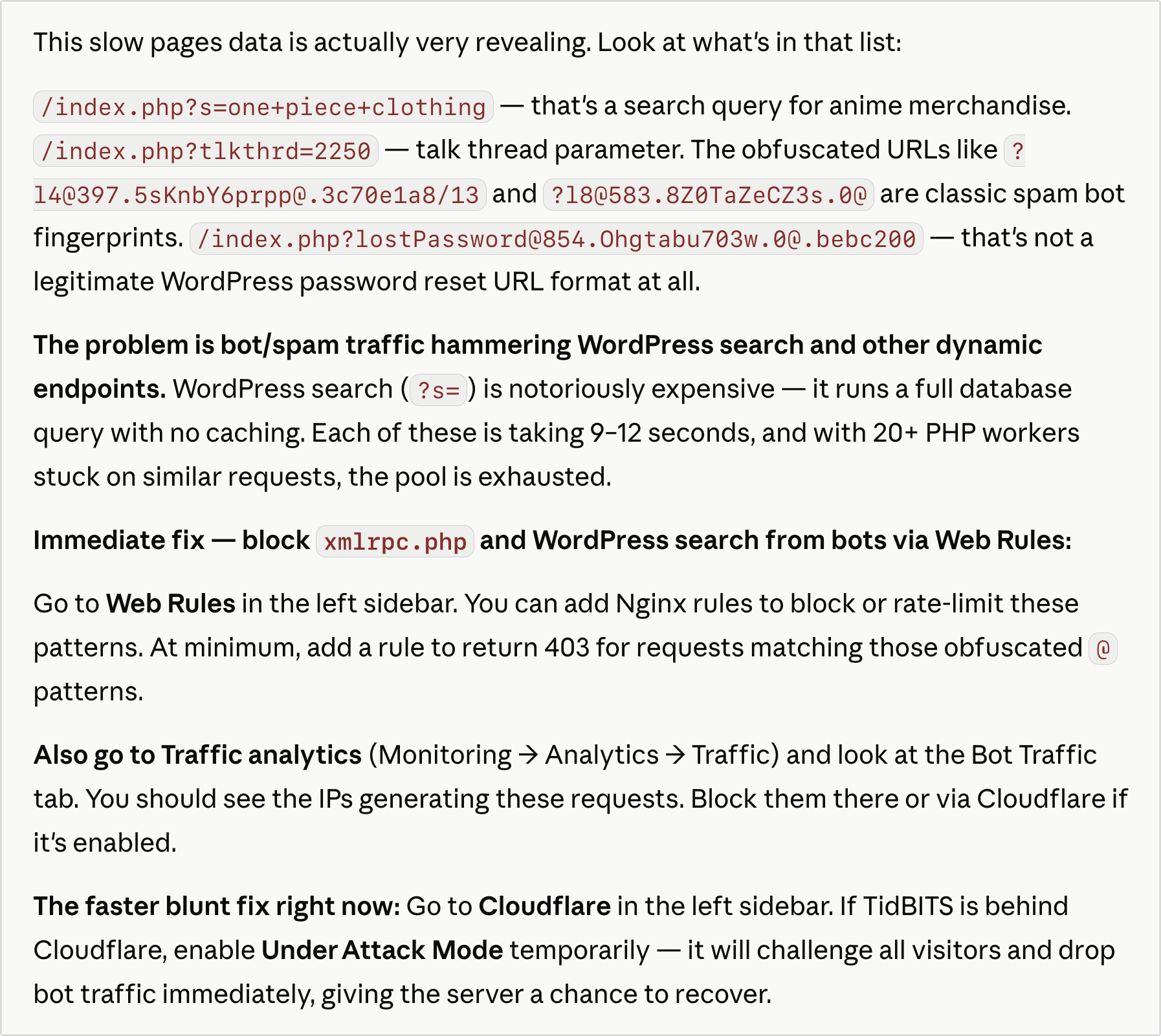

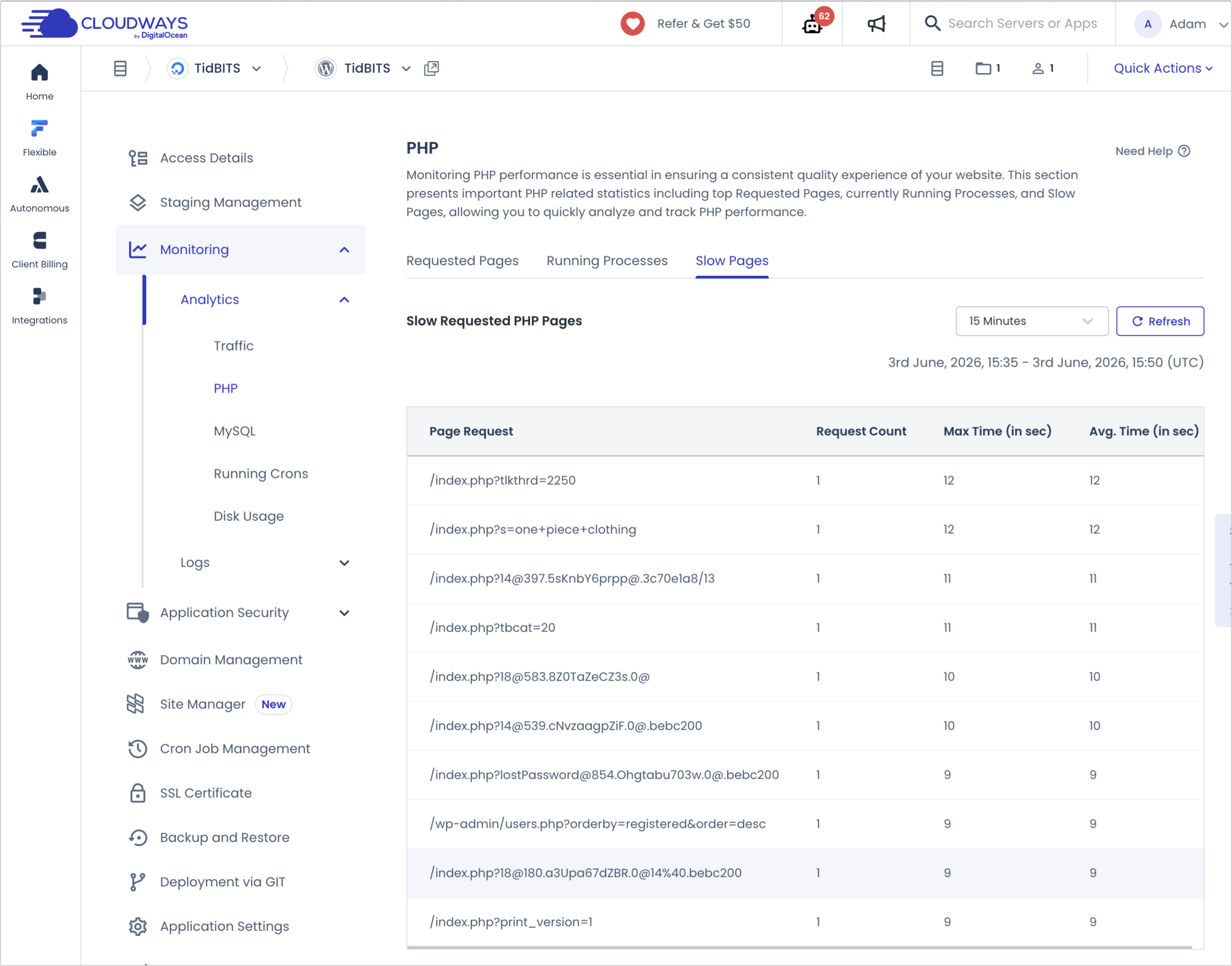

After some back-and-forth about Terminal commands and interface directions, Claude directed me to the Cloudways slow pages report, which displayed the URLs that were taking a long time to load. Nothing in it seemed particularly problematic to me, but when I showed Claude the screenshot, it highlighted the numerous URLs that used @ characters. It was mistaken about what they represented, but it was correct that they were a problem—more on that later.

With that awareness, I skipped several targeted suggestions from Claude and went straight to “the faster blunt fix right now,” which was to turn on Cloudflare’s Under Attack Mode.  I was a little surprised that Claude correctly guessed that we use Cloudflare to manage traffic before it hits our Cloudways server. (If I hadn’t been distracted, I would have lectured Claude about its performative bot-speak.) I only vaguely knew about Cloudflare’s Under Attack Mode, and in looking for it, I also stumbled on Cloudflare’s Bot Fight Mode, so I turned on both. (Apparently, I should have had Bot Fight Mode on before this.) That blocked the damaging traffic, but htop showed numerous MariaDB processes that were consuming resources and blocking database access. It offered some ideas for how I could get rid of them but also said they’d go away on their own. Since the site was responding again, I opted to let them expire naturally, which they did over time.

Throughout all this, Claude kept suggesting that I set up firewall and caching rules in Cloudflare to handle all this traffic. In the hope that wouldn’t be necessary—we had been fine for almost two years without those rules—I turned off Under Attack Mode to see if the bots had given up in the meantime. CPU usage, which had dropped to a normal level after the MariaDB processes expired, immediately started climbing again, so I re-enabled Under Attack Mode and decided to keep it on for the rest of the day. Maybe the bots would go away overnight. They didn’t. On Thursday morning, I turned off Under Attack Mode again, saw CPU usage spike, turned it back on, and set out to add those rules.
Cloudways CPU usage graph

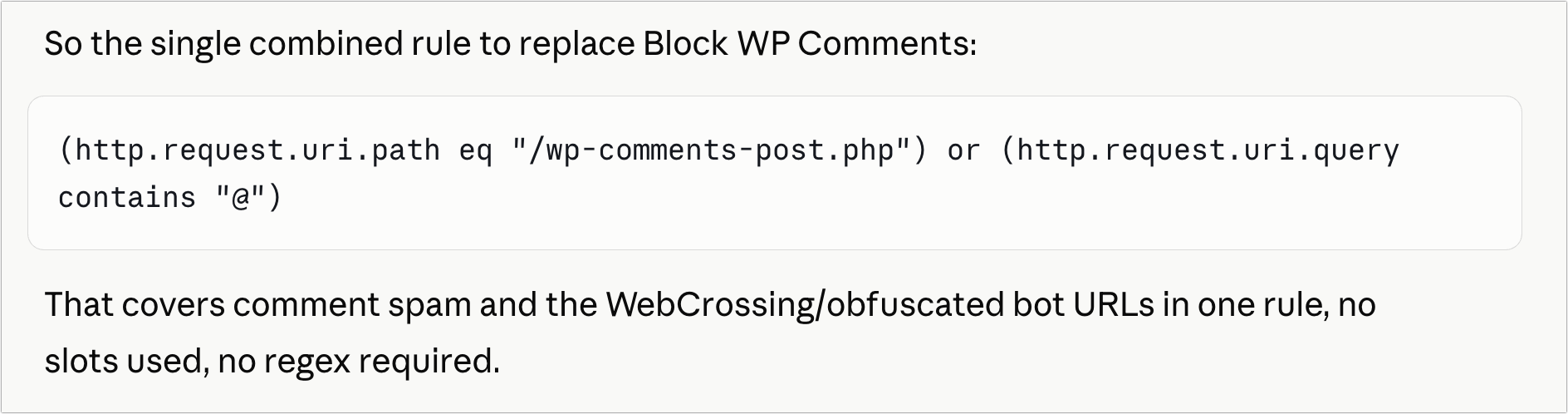

During this time, I recalled where those unusual URLs originated: from about 2004 through 2011, our Internet services relied on a system called WebCrossing that used URLs with @ characters. I suspect the attackers hoped those old links pointed to unprotected resources. Although that was not the case, I have always aimed to ensure that, if old tidbits.com URLs fail, they do so gracefully, so the site can still serve something reasonable.
Creating the firewall rule turned out to be more complicated than expected because Cloudflare’s free plan offers only five rules, and I had used them all. Claude explained that I could expand one rule to check for multiple criteria, and after I worked through the fact that free accounts also couldn’t use operator matches, it provided a solution.

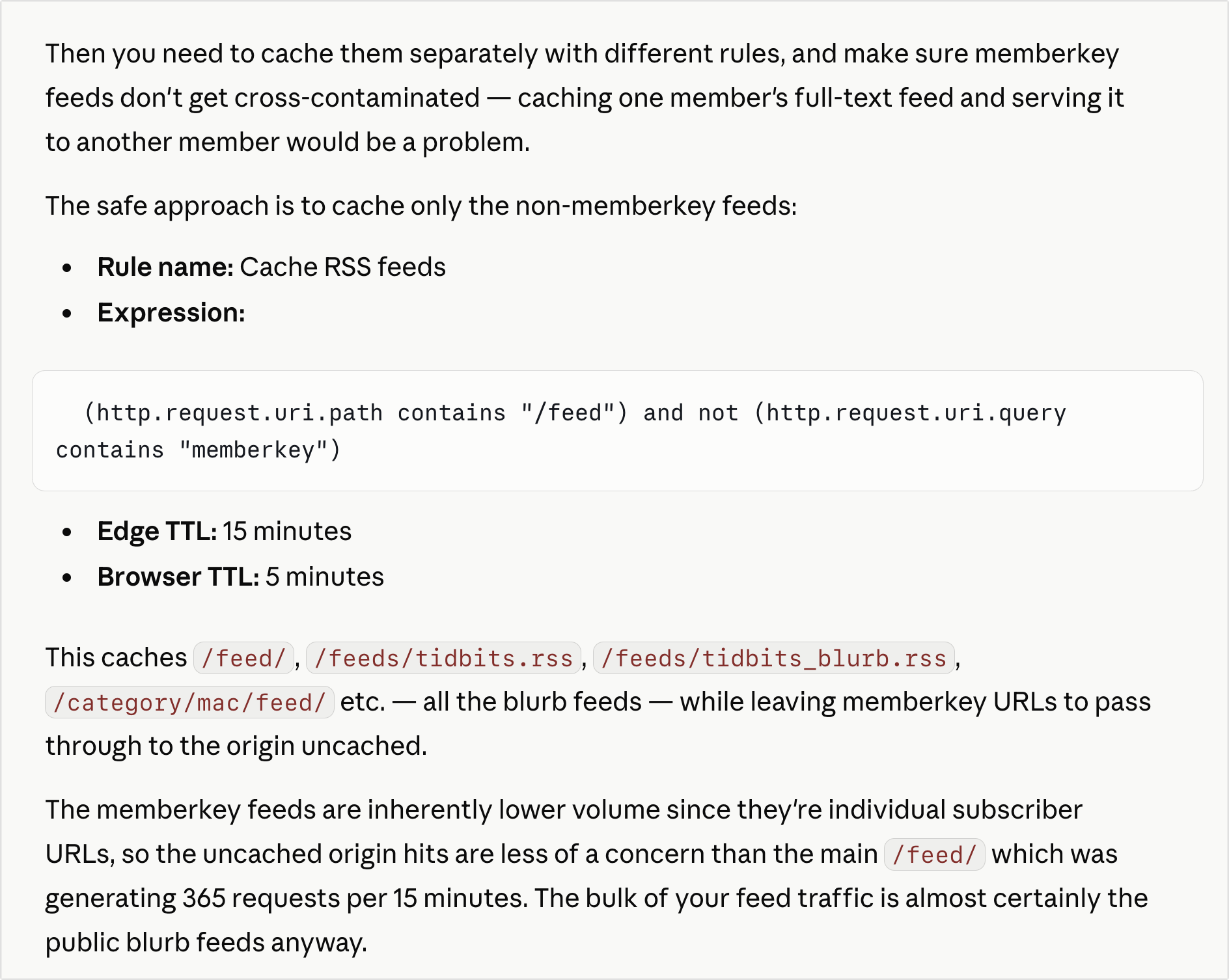

Then I moved on to the cache rule for RSS feeds. Claude was clever enough to realize that we have both public blurb-only fees and private full-text feeds for TidBITS members. Although the private feeds are identical apart from the URL, I decided it was safest to go with Claude’s incorrect assumption that they were personalized and keep them out of the caching setup.
Claude troubleshooting help

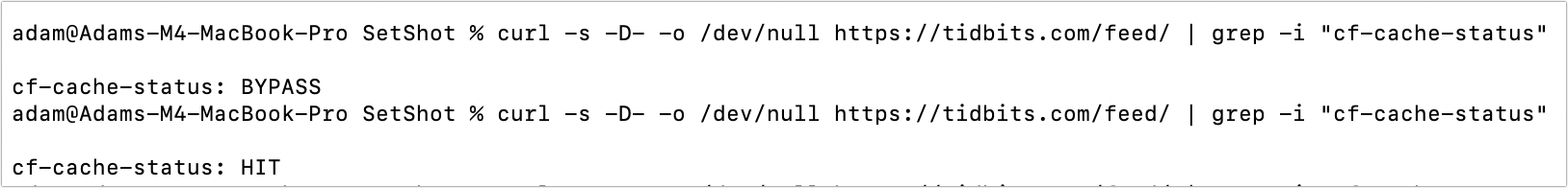

Once that rule was in place, Claude suggested a Terminal command I could run twice in quick succession to see Cloudflare invoke its cache. The first one showed the cache being bypassed, while the second (and subsequent) instances showed a cache hit, indicating that Cloudflare was serving the data rather than our server.
