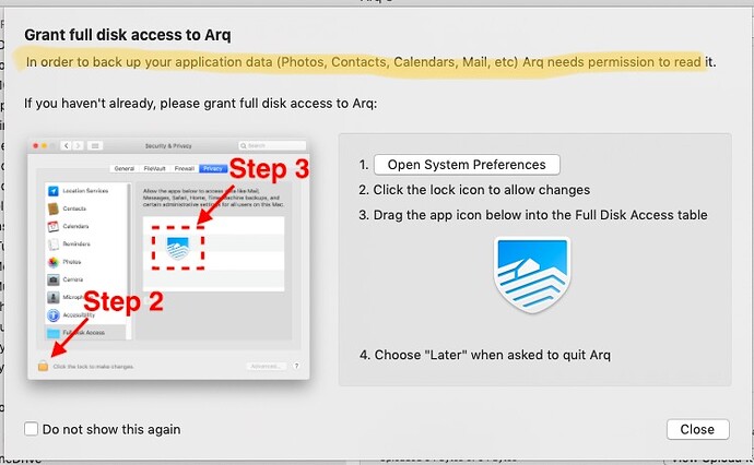

  8. Does anyone know if Arq has the same problem (and solution) under Mojave?
  9. The first time that you run the Arq app, it presents this dialog:
    I just did a test restore of file that were backed up before I granted that access - it restored just fine.
  10. Excellent! Thanks!
    Regarding your test, I’m not sure Arq needs that access to Restore any files, but it probably needs it to back them up, especially based on the wording in your screenshot.
    The fact that it prompts is a good sign.
    A real test would be changing some file outside of its sandbox (which is what?) and see if that gets backed up. Them well know for sure it can back up everything.
  11. I don’t think so; I think it is for restoring files. I installed Mojave early last week, the file was backed up last Friday, and I just allowed access to Arq when I made that post.
  12. I take it back: reading up on this, for Arq, it is for backing up. The reason that my system was backing up before I granted full disk access is that I was testing folders that aren’t protected I believe.
  13. Aha, okay.
    In that case, it’s not good that Arq didn’t ask you for that permission until now. What has it been doing since you upgraded to Mojave? Silently not backing up your files? Not good!
